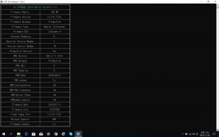

I tried to clear ME about ThinkPad X1 Extreme(MTM:20MFCTO1WW).
However I couldn't find the ME file version (12.0.6.1120) with firmware size 0x27C000h.
Would you please send me the ME file if you can ?
Thanks.

I'm afraid, but I still don't know how to convert the .bin file to .aes file when I use the Flash image tool.
(I couldn't the .bin file from LBE program although I copied the ME .bin files to ME folder)
Could you explain me on how to make the .aes file from .bin that you uploaded ?
It will also be very helpful if you tell me the way by using the Flash Image Tool .
Thanks.

Hello,
I found that there was a mistake to copy the ME file(.bin).
So I can use the ME files that you uploaded on the LBE program.
However firmware size is different even if the ME version is same as 12.0.6.1120.
The firmware size are 0x27C000 or 0x77C000. while ME file firmware size are 0x264FD0 or 0x900FD0.
How can I clear the ME file if the firmware size is different ?
Thanks.

I have already downloaded the ME 11_ME 12 files nad moved to the ME11_12 folder.
However firmware size is different even if I found the ME version of 12.0.x.xxxx.
I have attached a sample BIOS which is working well, need to clear the ME for test.(Thinkpad P1 20MEZ47YUS)

I tried to apply the new BIOS but it didn't work.
The symptom is that it didn't work at all, not display , not power on.
